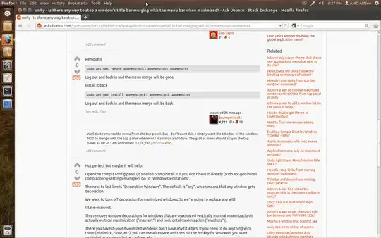

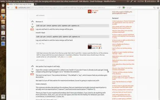

I simply want the title bar of the window NOT to merge with the top panel whenever I maximize a Window. The global menu should stay in the top panel as far as I am concerned. Current it maximizes like this
I want it to maximize like this (In that screeny the unmaximized Window has been resized to take rest of the space)
