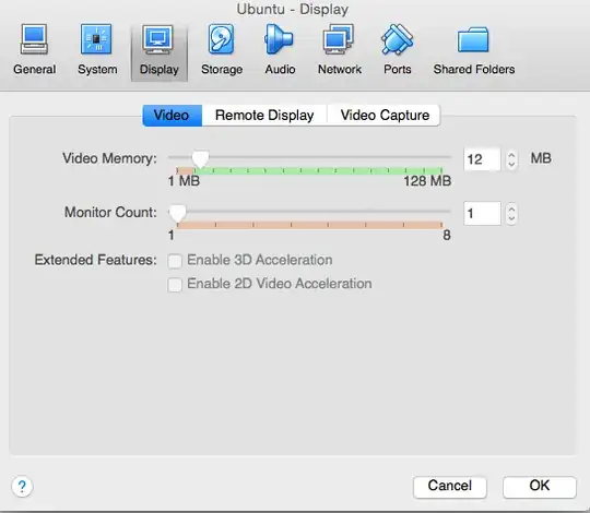

However, the display is really slow. Looking at the display settings I can see that the video memory is only 12MB but I can't move the slider to increase it. The checkboxes for extended features are greyed-out too. See screenshot.
How do I increase the amount of memory?

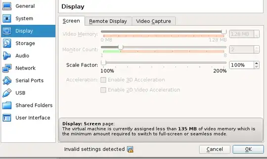

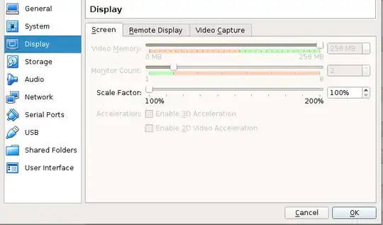

Running vboxmanage itself to find that --vram option but could not, however, using the command in top answer worked. Someone has posted that your VM doesn't need more RAM assigned to your display than needed so am posting my settings for Win7 running in 4k without any acceleration enabled that it complained about "not enough ram". Hope someone will find this useful. The last post is from Feb18 so this is an update that it works. Since someone posted here that it went black screen - advice is - clone your VM and test it there first if it works.
Settings before the change: Settings before the change
Settings after the change: Settings after the change
