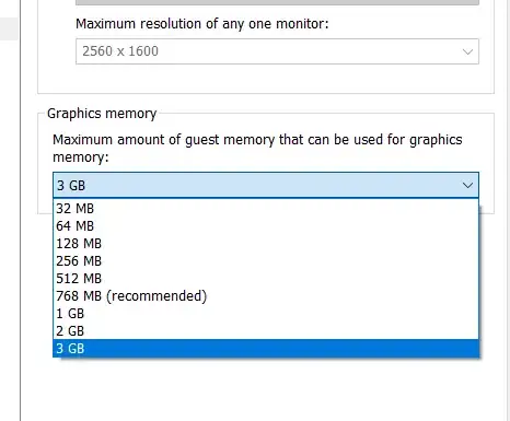

Use VMware player instead, it allows 3gig of VRAM.
which is ridiculously low by today standards.
Yes, it is. OP is 100% correct.
256mb is just too small for many applications, not just games. The other answer says its enough for an 8 x 4k displays, maybe (i highly doubt it will run at all well). Some software will disable features when less than 1GB of VRAM is available.
So even if you could increase it there is NO reason to have more than 256Mb.
There are many reasons to do so hence the OP asked and hence I run all my VM's with 2gb of Vram.
