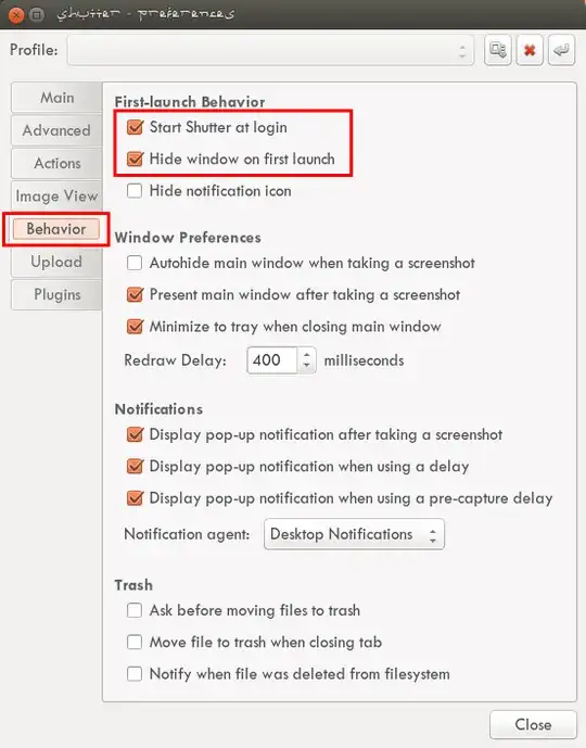

Using shutter
First install Shutter if you don't have it installed.
sudo apt-get install shutter
Open up preferences under Edit -> Preferences and select the behaviour tab.
Check 'Start shutter at login' and 'Hide window on first launch'. See screenshot below:

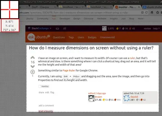

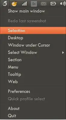

  1. Make sure the shutter panel icon is visible and select your window or whatever you want to measure.
  2. Click on the shutter icon and select 'selection'.

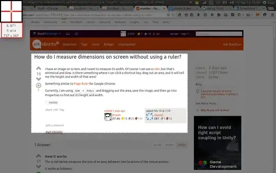

  1. Select your starting point and drag to your end point. The whole window will darken except your selection. You can move the borders around to get more 'to the point' results.
  2. Shutter will provide a dialog window with the X and Y coordinates and the size (which is what you want) of the selection. See screenshot below in the top-left corner of an example.
  1. A zoomed out screenshot showing it to be 727px by 367px:
  1. Finally just press Esc to dismiss the selection and hide shutter.

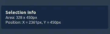

Using slop
Another simple way of determining the area of a selection is by using slop (Select Operation), a command-line utility "that queries for a selection from the user and prints the region to stdout."
slop is a comparitively new tool and has not been packaged for Debian/Ubuntu, yet. As it stands you will have to compile it from source:
sudo apt-get install build-essential cmake libxext-dev
git clone https://github.com/naelstrof/slop.git
cd slop
cmake ./
make && sudo make install
The installation is the most difficult part. slop itself is actually very easy to work with. For instance, the following one-liner will prompt you to select a screen area and will both display the result as a notification and write it to the clipboard:
eval $(slop -t 0 -b 1) && notify-send  "Selection info" "Area: ${W} x ${Y}px \n Position: X = ${X}px, Y = ${Y}px" && echo ${W}x${H} | xsel -bi
Screenshot:
A quick breakdown of the commands used:
  • slop -t 0 -b 1 - prompt the user to select a screen area; do not select full windows (-t 0), set selection border to 1px (-b 1)
  • eval $(...) - read output of slop into variables
  • notify-send ... - send GUI notification with information on selected area
  • echo ${W}x${H} | xsel -bi - copy dimensions to clipboard (requires xselsudo apt-get install xsel)
