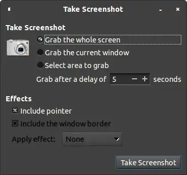

Run the Screenshot program (gnome-screenshot, or search for Screenshot in the Dash). Set a timeout (or delay):
gnome-screenshot
And then get the menu and wait for the timeout to expire.

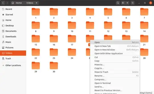

This only works with a whole-screen screenshot. So you'll have to manually crop later:
captured drop-down menu

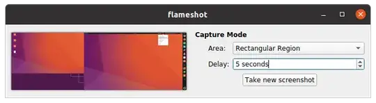

Use Flameshot, it also has an option to capture a rectangular area so you won't have to manually crop it.
Create a shortcut to these commands for easy access:
flameshot launcher
and
flameshot gui
Sample output:
