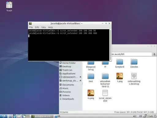

In Lubuntu, you can do exactly what you want: take a screen shot from the command line with the command:
scrot_extended 100 100 400 400
using the script below.
The four arguments are <x>, <y>, <width>, <height>.
I didn't have the chance (yet) to test it in Lubuntu 12.04, but it seems unlikely it wouldn't work; it uses python 2 and basic command line tools that exist for a long time already.
Explanation
The script:
  • takes a screenshot with scrot
  • saves it into a temporary file
  • using imagemagick, it creates a new image, cropping the screen shot, with the arguments you ran the script with
  • the image is saved into a directory as a numbered file, to prevent overwriting
How to use
  1. The script uses both scrot and imagemagick. scrot should be on your system. To install imagemagick:
     sudo apt-get install imagemagick
  2. Copy the script into an empty file
  3. By default, images are saved to ~/scrot_images, named: outputfile_1.png, outputfile_2.png etc. . Change it if you want, as marked in the script. Note that if you change the diretory, you have to use the full path.
  4. Save the file to ~/bin (create the directory if needed) as scrot_extended (no extension) and make it executable.
  5. Log out and back in and take your screenshot with the command:
     scrot_extended <x> <y> <width> <height>
Example:
outputfile:
