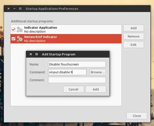

One option would be to have the xinput disable 9 command run automatically at every boot.
You can do this with the Startup Applications app installed by default in Ubuntu. Open the app and click the Add button to add a new Startup program.
  • Set the Name field as anything you like. (e.g. Disable Touchscreen)
  • Set the Command field as xinput disable 9.
  • The Comment field can be left blank.
Once you have this done simply click Add and it will take effect next time you reboot.
Note: This will only run once you have logged into the user account from which you created it. If there are other accounts that you need to disable the touchscreen for you can repeat this process for each user account or you can follow the instructions here to enable it for every user.
