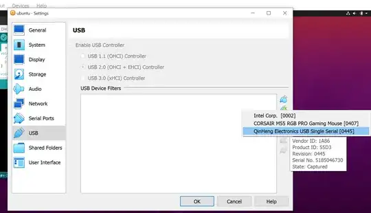

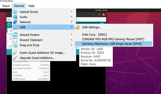

This is what I did to solve the problem using virtualbox:
  1. From the tool bar, go to Devices and check the USB list of devices.
Step1
  1. If it's there then you have to add it from the setting.

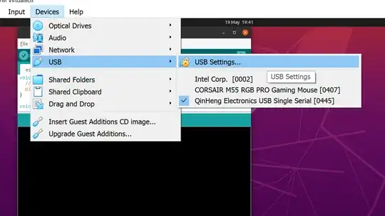

Step2
Step3

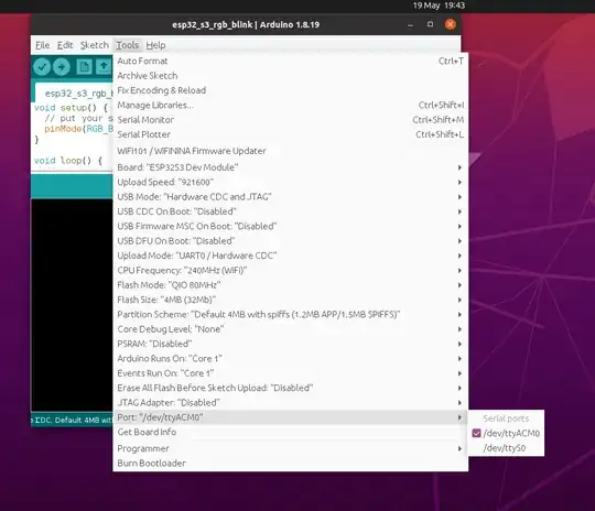

  1. Finally, you can find it on your application.
Step4
