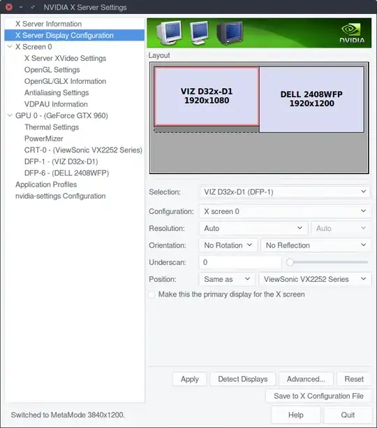

If you have an NVIDIA graphics card, you can do this rather easily in NVIDIA X Server Settings.
Under X Server Display Configuration, select a monitor and for its position, select "Same as" and then the name of your monitor, for example "ViewSonic VX2552 Series".
Example of mirrored displays
If your monitor and TV have different resolution, you can scale one of it by clicking Advanced... and set ViewPortIn to matching resolution.
