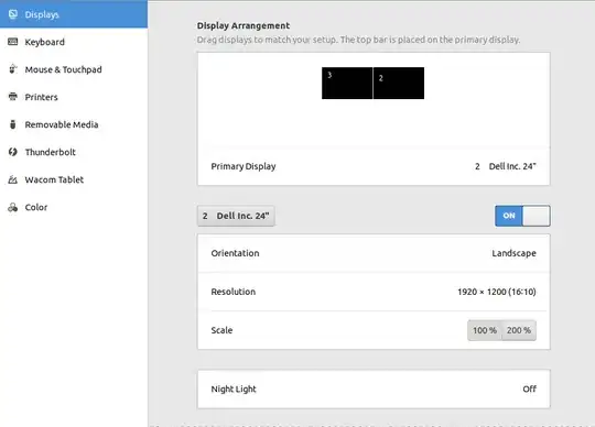

I don't find an option to mirror my Displays on Ubuntu 18.04:
I am running Ubuntu on a Dell M3800 with hybrid graphics.
What might cause this?

Update The output of xrandr --query:
Screen 0: minimum 8 x 8, current 5760 x 1200, maximum 16384 x 16384

The other very quick solution on both 18.04 and 19.04 is to use the keyboard shortcut: [Windows key + p] and then cycle through to get the right configuration.
From this answer: How can I mirror one of the screens in a 3-monitor setup? try using:
xrandr --output eDP-1-1 --output HDMI-1-2 --output HDMI-1-2 --same-as HDMI-1-1
In the accepted solution above, screen 3 is mirrored to screen 2 but the primary screen is not mirrored.
Another option is switching to Unity desktop: GNOME in Ubuntu 18.04 and multi monitor setup
