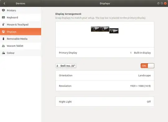

I just upgraded to Ubuntu 17.10 and I'm not sure how to enable mirrored displays (i.e. all displays show the same thing) since the UI has changed.
Tried following the steps in the official docs which mention a "Mirror" option in "the list of monitor configuration".
I'm unable to find such an option. This is what my Displays config looks like:
Screenshot of Displays control panel

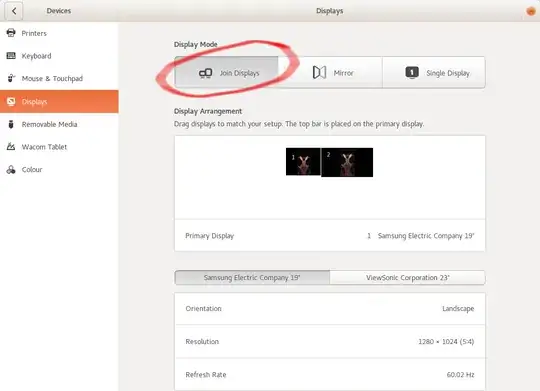

You should have some extra options at the top of the screen , not shown in your screen shot.
See this screenshot which shows the display mode at the top.
You need to select "Join Displays" - circled in red. That should do the trick for you.
