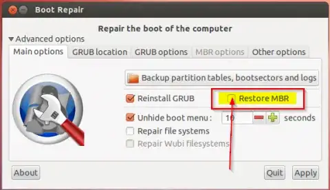

You may download the Boot-repair Disk iso images and burn it to a USB stick. Then, boot the stick and repair the MBR on the defected hard disk as you like. Both 32-bit and 64-bit versions are available.
It really works, I use it to repair a Win7 disk which MBR was accidentally over written by GRUB during the installation of Debian.
