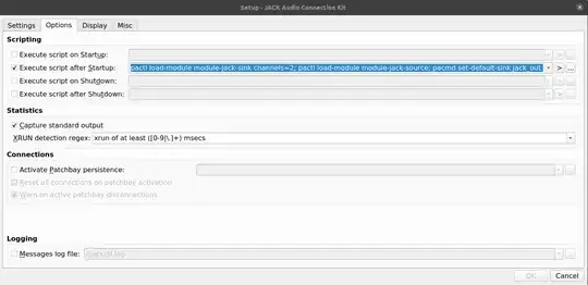

Just install qjackctl and pulseaudio-module-jack module:
apt-get install qjackctl pulseaudio-module-jack
Then configure qjackctl to run the following command after startup. Copy it into "Setup..." > "Options" > "Execute script after Startup":
pactl load-module module-jack-sink channels=2; pactl load-module module-jack-source; pacmd set-default-sink jack_out
And that's it. Pulseaudio will recognize (through D-Bus) that JACK started, and automatically will route audio to it. When JACK is stopped Pulseaudio will revert to normal routing and start sending audio directly to card again.

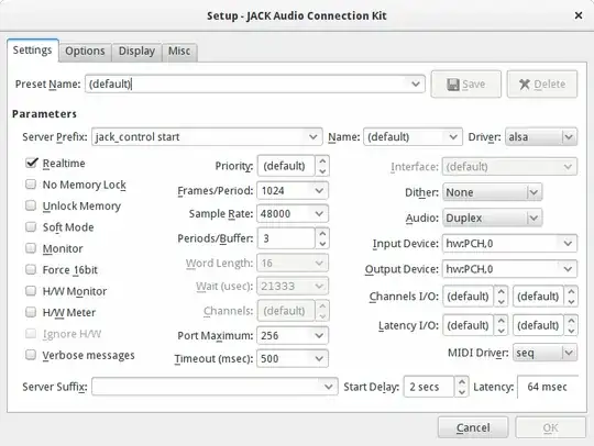

Configure qjackctl
Settings
The relevant fragment of ~/.config/rncbc.org/QjackCtl.conf:
[Settings]
Server=jack_control start
Driver=alsa
InDevice="hw:PCH,0"
OutDevice="hw:PCH,0"

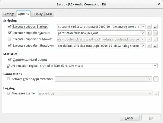

Here's one more fragment of ~/.config/rncbc.org/QjackCtl.conf to show the full commands
[Options]
StartupScript=true
StartupScriptShell=pactl suspend-sink alsa_output.pci-0000_00_1b.0.analog-stereo 1
PostStartupScript=true
PostStartupScriptShell=pactl set-default-sink jack_out
ShutdownScript=false
ShutdownScriptShell="pactl unload-module module-jack-sink; pactl load-module module-jack-source"
PostShutdownScript=true
PostShutdownScriptShell="pactl suspend-sink alsa_output.pci-0000_00_1b.0.analog-stereo 0; pactl set-default-sink alsa_output.pci-0000_00_1b.0.analog-stereo"

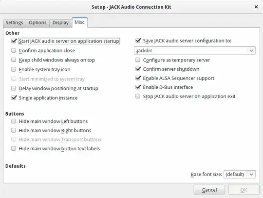

Misc "Enable D-Bus interface" is important for Qjackctl itself.

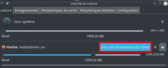

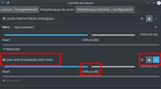

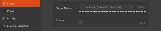

  2. In Ubuntu Settings, Select the JACK Sink as Output

    In Pavucontrol "output device" tab, clic green "default device" button near "jack sink"
    Now pulseaudio software and Hydrogen should run at the same time.

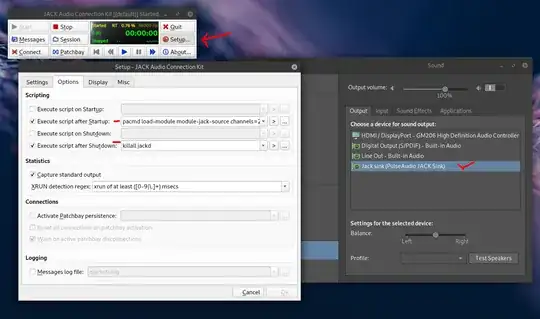

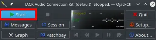

The easiest way to route all system to run with jack:
Install
sudo apt-get install qjackctl pulseaudio-module-jack
Open qjackctl. In Setup>Options>
Check Execute script after Startup and paste this:
pacmd load-module module-jack-source channels=2; pacmd load-module module-jack-sink channels=2;
Check Execute script after Shutdown and paste this:
killall jackd
Now start qjack and open your sound settings. You will find Pulse Audio Jack Sink Output port. Select it and all system will sync. If you stop Jack server/qjack, sound will go back to your Default port again.
[Here is the overall view]

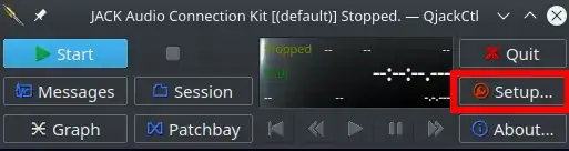

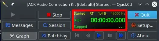

Run qjackctl:
$ qjackctl

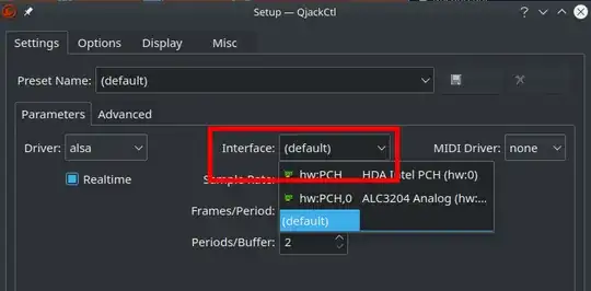

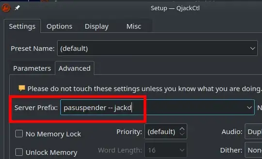

Click on Setup, and check that the output Interface is the correct one (if you have an HDMI output for example this check may be important). In my case, I'll just use the default and I'll come back here if I've some issues later. enter image description here
Then, in the advanced tab, I replaced the Server Prefix jackd with pasuspender -- jackd. This is supposed to tell pulseaudio to temporarily let jack manage the sound card. I'm not sure if it's really required, but I guess it cannot hurt: enter image description here

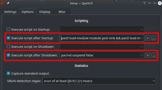

Then, in the tab "Options", put in the Execute script after Startup the following code:
pactl load-module module-jack-sink && pactl load-module module-jack-source && pactl set-default-sink jack_out && pacmd set-default-source jack_in && pacmd list-sink-inputs | grep index | sed 's/ *index: *//g' | xargs -I{} pacmd move-sink-input "{}" jack_out
The goal of this command is to create new outputs (sink) to pulseaudio that points to jack, to enable this new sink by default (all newly open applications will write to jack), and it also change the output of all the existing applications to make sure they point to jack.
Then, to make sure pulseaudio restarts when jack is closed, I also added in the field Execute script after Shutdown :
pacmd suspend false
That's it! Now, you just need to save by clicking on Apply and to click on Start to start jack:

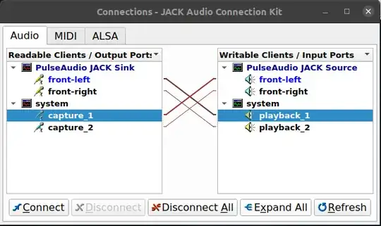

enter image description here You should see something like that if it works (and of course no errors): enter image description here

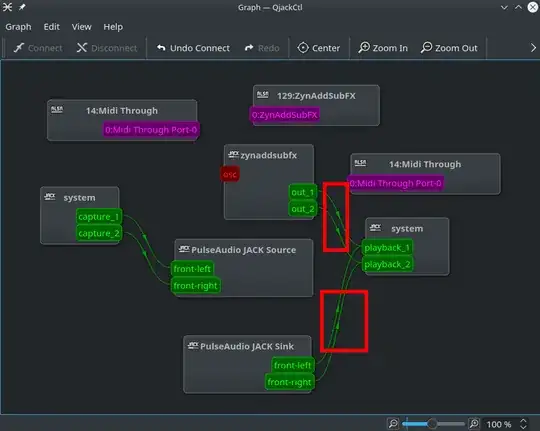

A bit of theory to understand why it works, or why it fails
So basically, you can't play sound because only one program can play sound at the same time on the same sound card. So when Jack is playing, pulseaudio is blocked. Now, it also turns out that most desktop applications can talk to pulseaudio but not to Jack. So when Jack is on, you just don't have sound anymore. The trick is to route the pulseaudio trafic to Jack with something like that:
application -> pulseaudio -> Jack -> sound card
Note that all links must be correctly configured. We will see now how they are configured and how to check if they are configured correctly.
So to create the link pulseaudio -> Jack we are going to load a module that creates a new pulseaudio sink (i.e. a virtual output device) called Jack sink: that way any applications writing in that sink will be redirected on Jack. You could have several already existing sinks, like one for the internal audio, and if you have a bluetooth headset, you can have one sink for it too. To check on which sink an application is actually playing, install and run pavucontrol (pavucontrol is super useful anyway for all sound-related stuff, since you can control basically everything from it). You can see the list of sinks in a tab named like Input devices (sorry if the translation is bad), in my case I have right now 2 sinks (jack is not yet loaded): enter image description here
If you just have one sink, you may not see anything interesting, but if you have several sinks, you can check in the first tab which application is playing on which sink (here you see that firefox is playing on my bluetooth headset), and you can change it if needed:
So if you have some issues, you can:
  1. link pulseaudio -> jack: check that you have a sink corresponding to jack (if not, try to run manually the command pactl load-module module-jack-sink that was supposed to be run automatically. If it fails, make sure you installed the pulseaudio-module-jack, and eventually restart pulseaudio by simply killing it killall pulseaudio. No worries, no need to restart pulseaudio, it respawn automatically.). Also make sure that the volume is not 0%, and that the channel is not muted: enter image description here
  2. link application -> pulseaudio: check that your applications are writing on that sink. If not, you can manually change the sink (but the startup script was supposed to change the sink automatically) that way: enter image description here
  3. link jack -> sound card: If you still have troubles (this part could also concern a trouble you have with the softwares that write on jack directly like zynaddsubfx), check out the Graph part of jack:

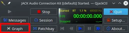

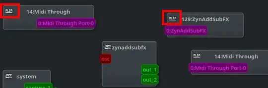

You should start will all nodes packed together, but you can move them to make them easier to see. Then make sure that all applications you want to ear are connected to system (in my case zynaddsubfx was not connected automatically). NB: if you have an older version of QJackctl, then you may have tabs instead of this. But it's the same: you will have green inputs/outputs in the "Jack" tab that you can manually connect, the violet ones will be in the "Alsa" tab, and the red ones in the "MIDI" tab... but in fact all external MIDI devices that you plug will appear in the Alsa tab: the reason is that there are two kinds of "MIDI": the legacy Alsa Midi (ports are global to the system), and the more recent Jack Midi (each application can have its own midi input/outputs).

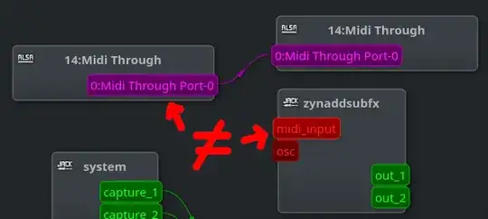

  1. Troubles with MIDI: In theory, to get midi, you can just connect the violet inputs to violet inputs (or in the Alsa tab in the older version, yes I know it's strange that you need to go in Alsa tab and not Midi to get Midi(!!!) but it's because of the difference between Alsa MIDI vs the more recent but less used Jack Midi). However, it turns out that for some strange reasons, zynaddsubfx has some strange defaults values and will appear as "Midi/red" instead of "Alsa/green", making it impossible to connect to an external midi device. More precisely, if you run zynaddsubfx from the command line without any option or with:
zynaddsubfx -I alsa -O jack
(which means input from Alsa MIDI, output to jack) it should not be a problem, you will be able to connect the MIDI devices:
However, if you run it in a graphical way, the default Jack entry automatically runs zynaddsubfx -I jack -O jack instead... And it will have the issue that the zynaddsubfx input will be created in red/MIDI tab, while the actual external MIDI device is in violet/Alsa tab. So it means that you won't be able to map your external midi keyboard to zynaddsubfx:
The solution is therefore to run zynaddsubfx using command line without options, or with zynaddsubfx -I alsa -O midi and everything should work!

  8. In the main System Settings for Sound, select the required output device.

  • jack cannot start while pulseaudio is running (and using the soundcard driver it wants to use which is fair enough) so it needs to be started first
  • pulseaudio needs to be pointed to jack once both up and running
Pretty simple..ey? For certain reasons, I had endless grief with it cuz..
First I think because pulseaudio 4.0 seems be buggy and mess up the alsa driver so that in some situations it leaves it locked and therefore jack cannot start even though pulseaudio is not running. (Says failed to set capture parameters or smtg like that)
What I deed in the end was
  • removed both jack and pulseaudio completely (with find and rm -rf :D after apt-get purge)
  • installed pulseaudio 11 (from sources)
  • installed jack and it's libs (libjack-dev)
in this order and then I finally got them running normally through qjackctl which makes sure they start in the correct manner (loads the jack sink in pulseaudio, and sets it as default).
Btw, I saw Cadence is recommended instead and I don't understand why as to me it seems rubbish compared to qjackctl.
Anyway, problem is starting jack using qjackctl takes a while and to avoid the waiting times at each boot you can use this life saver feature of kde which is to load previous session. Make sure you don't have qjackctl in autostart though as you will end up with one more instance at each reboot regardless of the singleton = true setting (buggy buggy all night long).
This is because I didn't feel fiddling around with it any longer such as writing a smart script that will make sure pulseaudio is down (or suspended) start jack and check that it started properly, then start pulseaudio, load jack module etc.
Otherwise relying on the OS to start the daemons and load config correctly would be the normal (healthy) scenario however it doesn't seem to be happening.
Have fun..
