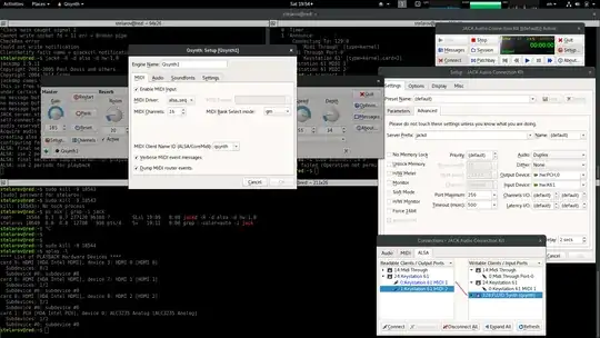

My pipeline scenario that finally worked, using jack-control (qjackctl) and qsynth was:
  1. Install jack-tools, jack-server, qsynth
  2. Open up qsynth and go to Setup. In MIDI tab, I select Midi Driver: alsa-seq. In Audio tab I select Audio Driver: jack.
  3. Fire up jack server with
    jackd -R -d alsa -d hw:1,0
  4. Open qjacktctl and:
4.1 Go to Connect -> ALSA. In the left column find out your keyboard and connect it to qsynth that lies in the right column. Also make sure that in the first column (AUDIO), qsynth is connected to your speakers (right column).
4.2 Back in the main qjackctl window Go to setup->settings->advanced and in the right column, choose Output Device (speakers) and Input Device (Midi keyboard)
By this step I was able to hear my keyboard. An overall screenshot of the setup follows
PS: In this scenario no other application can use the speakers at the same time.
