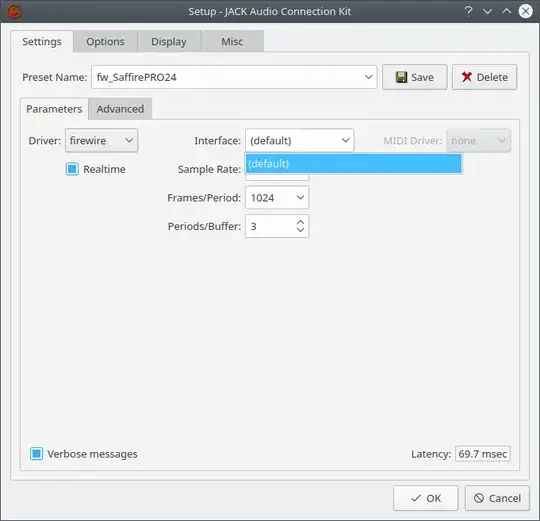

but i can't get jack configured to use the alternative firewire driver (ffado) -

i can't get jack to see the card:
have i missed something here?
i thought that the card should pop up in this list - especially if i have blacklisted the other driver..
