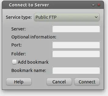

EDIT: Thank you @con-f-use for reminding me this one. You can add bookmarks from nautilus only. Go to File > Connect to Server... on nautilus and you will be presented with dialogue window where you have the option to add a bookmark of desired name. Just check the add bookmark option and enter the bookmark name. But I think it starts the mounting only after you click the bookmark unlike gigolo.
