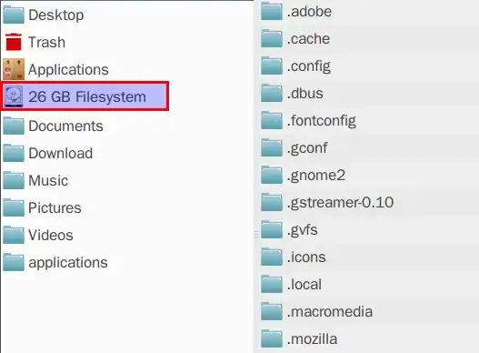

Here's a picture of the left pane in pcmanfm with the Windows partition (not mounted yet)
left pane of file manager

No. Format a USB flash drive as Ext3/4 and you'll see it appear there too. If you would have another partition on your hard drive without any mount point specified in /etc/fstab it would appear there too.
The way the file manager mounts and manages the mounts as shown in the sidebar, has nothing to do with the system mounts. It's about what is mounting it. Using
gvfs-mount -l
you can see which are already managed by your desktop environment. This answer and the manpage of gvfs-mount will explain quite well how to mount filesystems the command-line way the same way as your file manager does that programmatically.
GVFS uses FUSE, an user space level filesystem approach, rather than in-kernel. It's about who manages the mounts on your system. The regular GUI file manager does not manage the system mounts (cat /proc/mounts) by design.
