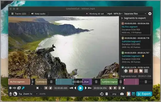

LosslessCut is focused entirely on clipping/cutting, is simple to use and does not re-encode, meaning exporting is fast:
sudo snap install losslesscut
Screenshot of LosslessCut
To ensure audio remains synced with image, use the keyframe cut option.
Github repo.

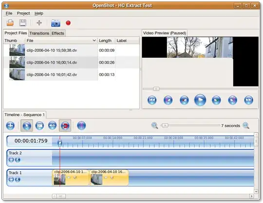

OpenShot Video Editor looks promising. Have you checked it?. Checkout the features: http://www.openshot.org/features/
The official installation method is via AppImage available at https://www.openshot.org/download/
To install it just open a terminal and run the following commands:
sudo add-apt-repository ppa:jonoomph/openshot-edge
sudo apt-get update
sudo apt-get install openshot openshot-doc
Just give a try. alt text

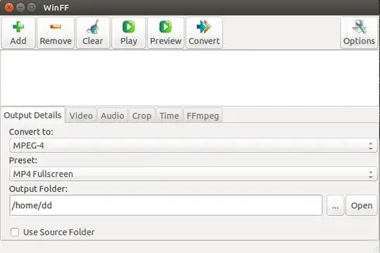

There is also WinFF that is avconv graphic interface. It works great. I installed it from Ubuntu Software Center.
Here is the screenshot: WinFF

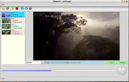

Use this
I've written it to cut out ads from recorded TV videos. Using the included remuxer you do not even to have to recode it. There is nothing fancy about it. Just fast.

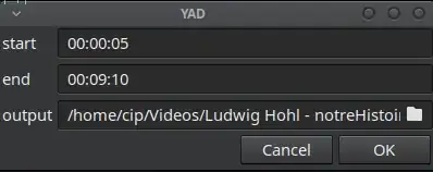

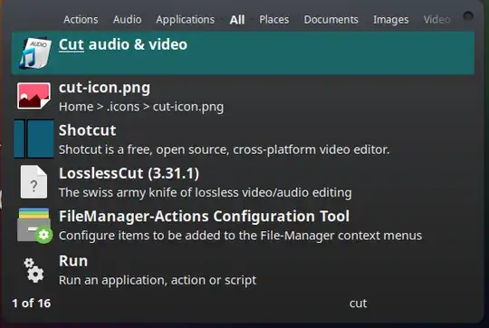

To just crop without trans-coding
(copying instead), I suggest a yad script to be run from a desktop file launcher.
I have found the script here.
I have modified it a bit to include video formats and to avoid transcoding.
It looks like this:
#!/bin/bash
INPUT=$(yad --width=600 --height=400 --file-selection --file-filter='.mp3 .mp4 .avi .m4a .ogg .flac .aac .opus')
eval $(yad --width=400 --form --field=start --field=end --field=output:SFL "00:00:00" "00:00:00" "${INPUT/%.}-out.${INPUT##.}" | awk -F'|' '{printf "START=%s\nEND=%s\nOUTPUT="%s"\n", $1, $2, $3}') [[ -z $START || -z $END || -z $OUTPUT ]] && exit 1
DIFF=$(($(date +%s --date="$END")-$(date +%s --date="$START"))) OFFSET=""$(($DIFF / 3600)):$(($DIFF / 60 % 60)):$(($DIFF % 60))
ffmpeg -ss "$START" -t "$OFFSET" -i "$INPUT" -c copy -map 0 "$OUTPUT"
So, install yad, save the script as cut_audio-video.sh and make it executable.
Than create the file ~/.local/share/applications/cut-audio-video.desktop similar to:
[Desktop Entry]
Name=Cut audio & video
Exec=/PATH/TO/cut_audio-video.sh
Icon=/SOME/AUDIO/ICON/Audio-icon.png
Terminal=false
Type=Application
Categories=GNOME;GTK;Settings;HardwareSettings;X-GNOME-Settings-Panel;System;
Change Exec and Icon lines.
Then it can be run with an app launcher like Synapse:
Select the file, then enter the time for start and end of the cut/crop

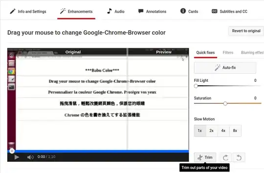

Yesterday I just found that I can do it online, With a youtube account:) If you are in a hurry, and do not have enough time to try which ubuntu software works for you, then do it online.
Go to youtube account, upload your video, then select Video Manager, there is a Enhancement option, at the bottom right corner there lies Trim option
Watch this 1 minute tutorial if you still can not find it
Screen Capture of the Trim menu

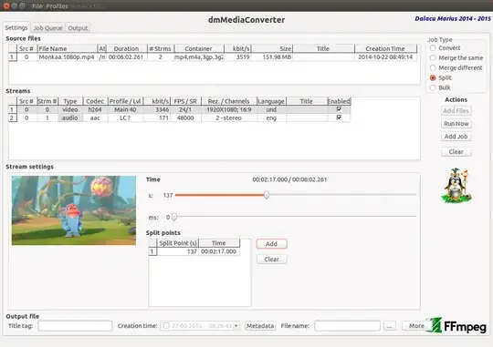

If you want a GUI application you can use dmMediaConverter, a ffmpeg frontend, which has a split function, without reencoding, fast. Just add the split points and press Run. Also, it can do a lot of other stuff. http://dmsimpleapps.blogspot.ro/2014/04/dmmediaconverter.html Split function example
