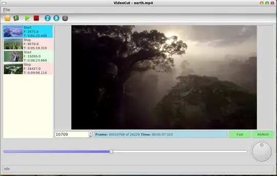

If you want it with a GUI:
Use VideoCut, it is based on ffmpeg and OpenCV. Goal of this app was to eliminate the ffmpeg commandline:
By default is does not re-encode. Your choice is to use the optimized "remux" muxer or the original ffmpeg code
