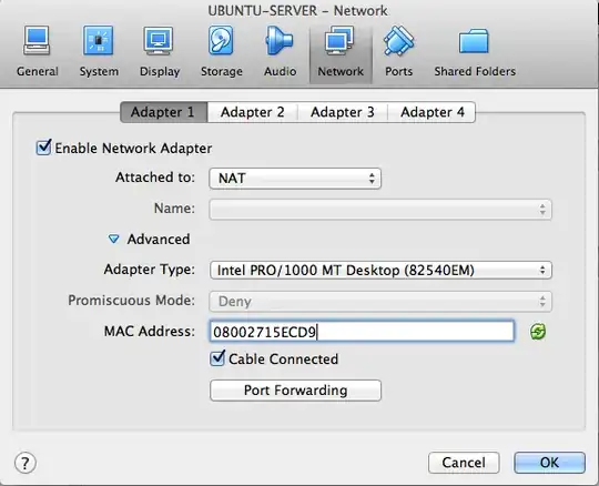

So it would seem like I have an issue with my network adapter. However, I don't really know what settings am I supposed to be using:
What do I do to be able to get my actual I.P address from Ubuntu Server running in VirtualBox for Mac OSX?

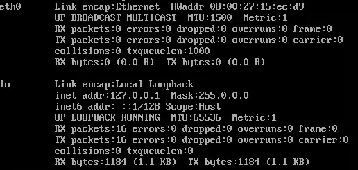

By request, here is what ifconfig says:

You don't have an IP address because you have not configured one. To do so you need to edit /etc/network/interfaces. If you want one to be obtained automatically, add eth0 to the auto line in the file, and add a new line for it that reads iface eth0 inet dhcp. You can then reboot or run sudo ifup -a to bring up the interface and obtain the IP address. See man interfaces for more information.

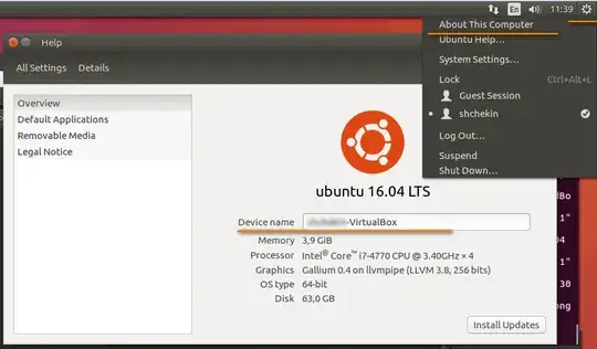

I used "About This Computer..." menu item to get computer's name and later ping command to get its IP. I hope this will be helpful for you. enter image description here
