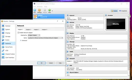

I selected Bridged adapter under the virtual machine's network settings: (I am on wireless Wifi connection, which is connected OK on host system - I can access internet OK)
bridged adapter selected
