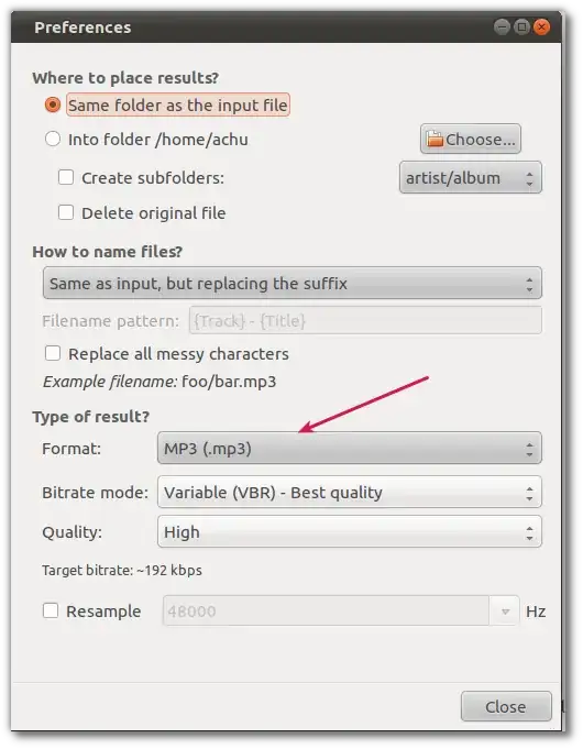

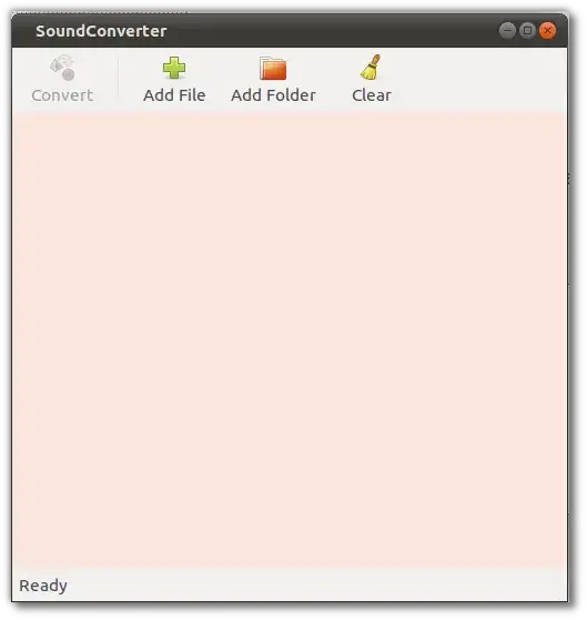

Install Soundconverter Install soundconverter
and run Soundconverter from launcher or terminal
The default conversion is .ogg change this to mp3 going to edit-> preferences under type of results. Format to MP3 as follow:
Click on add folder and then select your music folder. You may select the output folder on the above preference configuration before you clicking on convert.
Hope this will be done by two clicks :)
