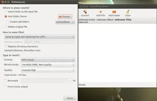

Sound Converter can convert Videos to Audio, and allows multiple files. It is the best program I have found to convert anything audio wise. It is installable from the Ubuntu software center.
When you run the program make sure to change your preferences, under the edit drop down menu, to what format you want to convert as well as many other settings.
Here is an example of converting a video into audio (MP4 to MP3) as you have requested.

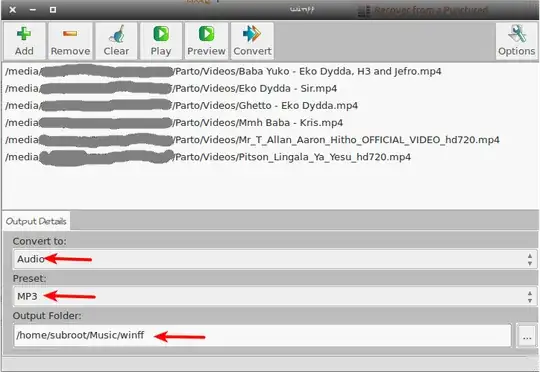

I have just converted six .mp4 to .mp3 using Winff 1.4.1 in Ubuntu 12.04, and it has worked smoothly.
The terminal window that opens up doesn't show errors but the conversion process and it will only tell you to 'Press enter to continue' after it's completed. Check the folder you chose as your 'output folder' for the mp3's.
Check screenshots below:
  1. Choose your files and select your options and click convert: enter image description here

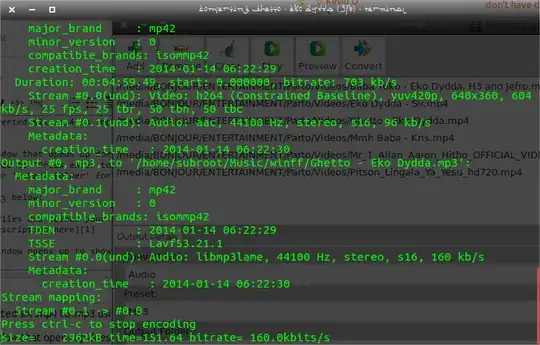

  2. A terminal window opens up to show you the conversion process (mine is semi-transparent): enter image description here

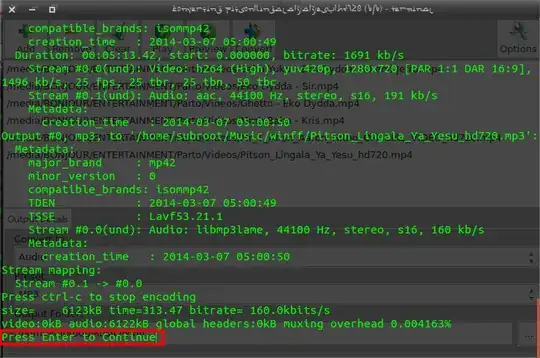

  3. After completion, that's when you get the 'Press enter to continue' text: enter image description here

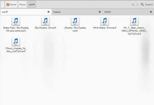

  4. Finally, navigate to your folder and get your mp3 converted files: enter image description here
