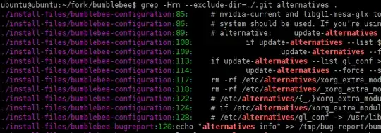

If you're looking for lines matching in files, my favorite command is:
grep -Hrn 'search term' path/to/files
  • -H causes the filename to be printed (implied when multiple files are searched)
  • -r does a recursive search
  • -n causes the line number to be printed
path/to/files can be . to search in the current directory
Further options that I find very useful:
  • -I ignore binary files (complement: -a treat all files as text)
  • -F treat search term as a literal, not a regular expression
  • -i do a case-insensitive search
  • --color=always to force colors even when piping through less. To make less support colors, you need to use the -r option:
    grep -Hrn search . | less -r
  • --exclude-dir=dir useful for excluding directories like .svn and .git.
Example output

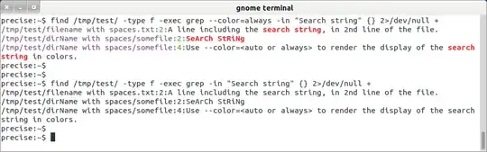

Update 2:
This line of commands using find and grep fixes the problem:
$ find path_to_search_in -type f -exec grep -in searchString {} 2> /dev/null +
--color=<always or auto> for colored output:
$ find path_to_search_in -type f \
            -exec grep --color=always -in searchString {} 2>/dev/null +
Example:
$ find /tmp/test/ -type f -exec grep --color=auto -in "Search string" {} 2>/dev/null +
An example run in the snapshot below: snap1
