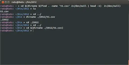

To check only for t1.csv, you can use:
find . -name 't1.csv'
Now, to go in the first directory where t1.csv file is found, you can use:
cd $(dirname $(find . -name 't1.csv' 2>/dev/null | head -1)  2>/dev/null)
Radu Rădeanu
  • 174,089
  • 51
  • 332
  • 407
if [ -f t1.csv ]
then
    echo "File is in target dir"
else
    cd `dirname $(find . -iname 't1.csv')`
    pwd
fi
