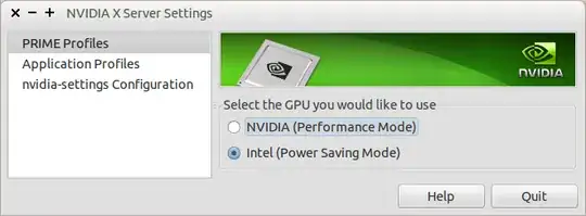

  4. NVIDIA Prime is a way of adding hybrid graphics support to your laptop. NVIDIA Prime allows the user to switch between NVIDIA (Performance Mode) and Intel (Power Saving Mode) graphics from the NVIDIA Settings utility.
    If your computer has an NVIDIA 319 or more recent graphics driver installed, run the following command to install NVIDIA Prime packages:
    sudo apt-get install nvidia-settings nvidia-prime
    Then NVIDIA Prime can be enabled/disabled from the NVIDIA X Server Settings application.
