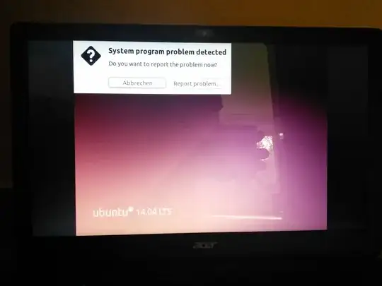

I am having trouble installing the current Nvidia proprietary driver 346.35 on a Nvidia 840M graphics card, in combinations with an Intel i5-4210U cpu, kernel 3.13.0-45 on Ubuntu 14.04.1 64 bit
After installing the driver (manually from Nvidia driver page) and restarting lightdm / rebooting I get to the login screen and everything is looking normal. Once I login the screen resolution gets distorted and nothing more than "System program problem detected" is displayed, Unity / Compiz do not load.

I've never had any trouble installing the proprietary Nvidia driver on linux before, maybe someone can help me here. The image below shows the bad screen resolution after login.
Bad screen resolution after login

Okay I have finally found a solution for the problem!
Thanks to these threads:
The solution is:
When the computer has booted up and you see the black screen press ctrl+alt+F1 and log in with your user account.
Edit your xorg.conf with sudo nano /etc/X11/xorg.conf
Find the line that says: Section "Screen"
Insert a new line that says UseDisplayDevice "DFP"
Save with ctrl+o+Enter and exit with ctrl+x
Next install bumblebee with sudo apt-get install bumblebee.
Then reboot sudo reboot
