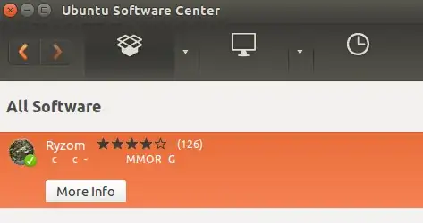

I recently bought a new laptop (ASUS-X555LN) with a 840M graphics card in it. I installed Ubuntu 14.04 64 bit with its install DVD, during and after the install, there are missing characters, like in the screenshot below:

Anyway, I'm confused. I already browsed a lot of discussions (like this and this) and tried the proposed solutions to the graphics card problem, but all of the times I ended up messing the desktop, (sometimes blank, sometimes 640x480). What is a guaranteed way of having no problems with my graphics card? Is there such a way?
Currently my driver options are: (also another example of my problem :) )
