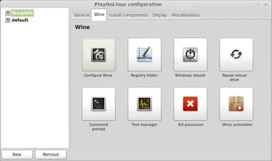

My preferred graphical front-end for Wine is PlayOnLinux, with that you have more control over your Wine environment, and there is a separate environment per application. So, if you happened to get infected by using Safari, use the Configuration options to examine and/or restore, or just delete the entire Safari Volume.
Excerpt image from here: PlayOnLinux Explained: Wine Configuration | GamersOnLinux

IMHO: PlayOnLinux is a safer alternative, because you have more control over wine, with the Configuration tools. Whilst installing only wine, installs a Windows environment in your Linux system without any way of monitoring it.
PlayOnLinux doesn't need wine pre-installed. It creates a Wine Prefix(a separate working environment) with wine. Then it will install the software in the separate Wine Prefix. Meaning, the software cannot access other environments. Thus making it harder to infect other parts of Windows software installed in a different Wine Prefix.
