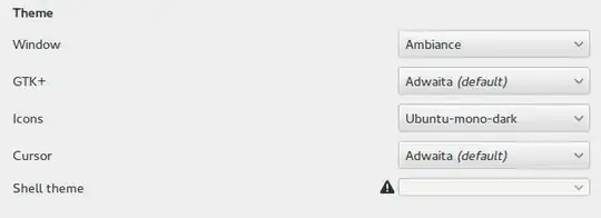

In Gnome Tweak Tool, I'm unable to change the Shell theme:
Hovering over the exclamation mark shows the following tool-tip: Shell user-theme extension not enabled. I'm using Ubuntu 14.10, and have installed gnome-shell-extensions.
I solved this problem myself, and it was an extremely trivial solution:
Gnome Tweak Tool.Extensions menu item, and move the User themes slider to On.Gnome Tweak Tool and open it again.Shell theme in the Appearance menu.In addition to @miceagol's answer: If you do not see User Themes in the Extensions panel of GNOME Tweak Tool, you may need to install it from extensions.gnome.org. Restart the tweak tool after installing.
