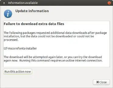

It looked kind of like it failed on the Comic Sans part. Viewing it just displays the text in another font.
Then this Failure to download extra data files window popped up.
I tried uninstalling ttf-mscorefonts-installer from the terminal and then reinstalling it by following the instructions in this answer. This time it failed to fetch the first font, andale32.exe. I got an error message that said: invalid content-range header.
What should I do?
