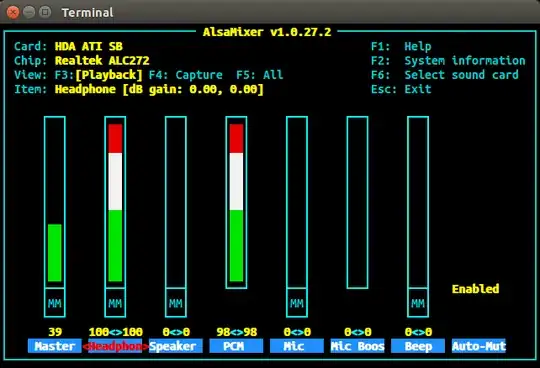

First of, open alsamixer program in terminal (Ctrl+Alt+T).
Check if automute is Enabled. You can navigate to it by using left-right keys, and up down to toggle the value. Esc to exit.
Now, if you mute sound without headphones , plug the headphones, and unplug them again, sound through speakers should stay muted. At least on my machine, with Auto-Mute enabled, I can keep speakers muted, while headphones can output sound upon plugging in.
