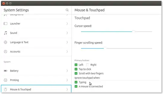

In Ubuntu 17.04 there's a "System Setting" for "ignore touchpad while typing" that might be generally useful (not enabled by default):
System Settings/Mouse & Touchpad
