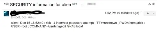

I have cron setup to backup every morning and email it to my gmail account and it works great. A nasty side-effect is whenever I type my password wrong using sudo I also get an email which is annoying:
incorrect login
I've googled a bit but can't find out how to turn off this email feature.

The flag is off by default - but enabled by Ubuntu's default /etc/sudoers file, as you have noted.
Presumably, you have started receiving these messages because sudoers default mailto is root - and you configured an MTA to deliver root's mail for cron. The messages should stop if you comment out the Defaults mail_badpass line (using sudo visudo).
