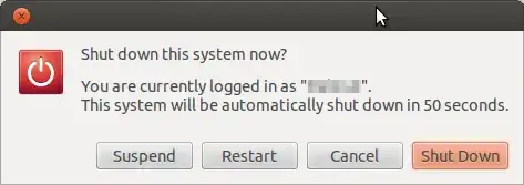

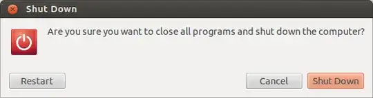

11.10 and later
Pressing Ctrl+Alt+Del leads to the logout dialog. If you need the old functionality back you will have to define your own shortcut by opening Keyboard -> Shortcuts from System settings and add this command:
gnome-session-quit --power-off
Alternatively we can use a shoutdown only dialog as shown in this answer
/usr/lib/indicator-session/gtk-logout-helper --shutdown
Note
Before we can use Ctrl+Alt+Del we will have to assign another shortcut to logout.

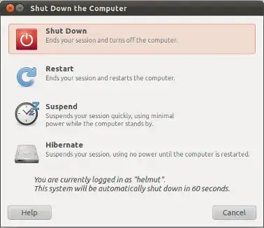

11.04 and earlier
Using default keyboard settings pressing Ctrl+Alt+Del will open the following window:
The first entry is selected by default for an immediate shutdown by just pressing Return in addition.
There also is a countdown that shuts down your system after 60s without any further keyboard action.

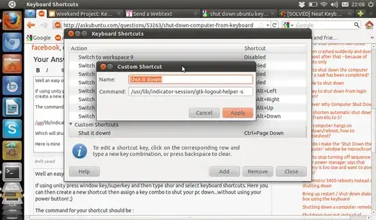

Well, an easy one to try is to open the keyboard shortcuts.
If using Unity, press the window key/superkey and then type shor and select keyboard shortcuts. Here you can then create a new shortcut and then assign a key combo to shut your pc down… without using your power button!
The command for your shortcut should be:
/usr/lib/indicator-session/gtk-logout-helper -s
Which will shut you down!!
Here is mine which I did to test it:
Shut down!

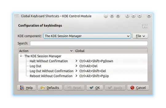

For KDE / Kubuntu
  • Shutdown: Ctrl+Alt+Shift+PgDown
  • Reboot: Ctrl+Alt+Shift+PgUp
  • Log out: Ctrl+Alt+Shift+Del
Confirmed to work in Kubuntu 12.04 and 12.10.
Or in Energy Saving settings, set the power button on your PC to do this:
