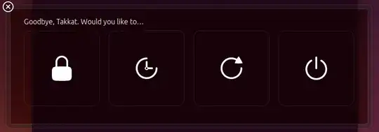

To be able to shutdown with a keyboard shortcut we can assign gnome-session-quit ---power-off to a custom shortcut.
In Unity this will lead to the following dialog:
Then we need another at least two keystrokes to finally power off our system. This is rather inconvenient and I would prefer the old shutdown dialog when you could poweroff by just pressing Return or letting it wait the default countdown of 60 seconds.

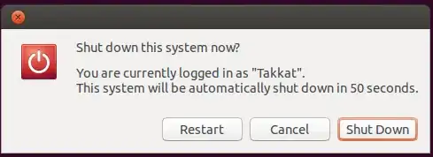

When calling gnome-session-quit --poweroff from a GNOME session flashback session on the same system (14.04 LTS) the old dialog including the countdown comes back:
So we know it dwells somewhere.
Is there any way to call this old dialog when running a Unity session?

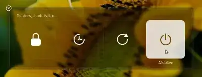

Not literally what you asked for, but at least an (effectively) comparable solution would be to put the script below under a shortcut key.
What it does
When the shortcut key is used:
  • the gnome-session-quit --power-off command is run
  • the mouse is moved to the corresponding "close" button, effectively making the shutdown button pre- selected:
Then:
  • If the user presses Enter, the system shuts down
  • If the user does nothing, the system waits for 30 seconds (or any other period of time you'd like to set) and shuts down.
  • If the user moves the mouse during the 30 seconds, the procedure is stopped
