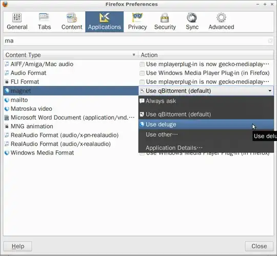

In Firefox go to Edit/Preferences/Applications, search magnet and set Deluge
