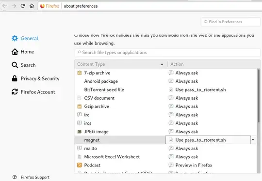

You can use this in a script (let's call it pass_to_rtorrent.sh) and have Firefox pass the torrent file or magnet link to the script:
Firefox rTorrent screenshot
Make sure the script is executable: chmod +x pass_to_rtorrent.sh
