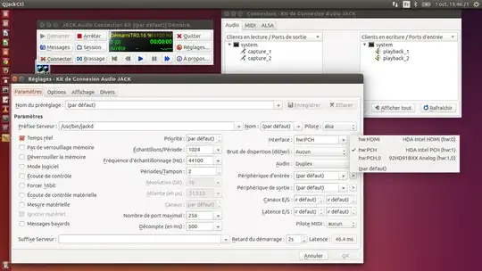

Run "qjackctl" (install it eventually) , clic "settings".
Look for the "interface" selection and clic on the ">" near it: you should see your usb device in the list.
Just select it and close and restart Qjackctl : now you should see "system" with "playback" and "capture" in the audio connection window .
Delayed recording problem : the delay on the recorded sound (latency) is caused by the "sample/periods" setting (1024 on the screen capture): set it to 128 or 256. The obtained latency is displayed in the bottom right : 5 ms or less is excellent , around 10 ms is ok.
