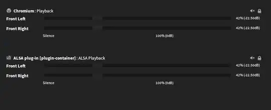

I want to record two live video streams (rtmp flash videos in a browser) at the same time and I'm running two instances of the SimpleScreenRecorder for that. Each instance records a different region on the screen. The only problem is sound. I use separate browsers so each browser has its own audio playback in pulseaudio.
How can I separate playbacks so that each playback stream will have a separate pulseaudio monitor? I have only "Monitor of Built-In Audio Analog Stereo", but I need two monitors, one for Firefox and one for Chrome.
