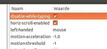

Alternatively, you can install dconf editor:
sudo apt-get install dconf-editor
Open dconf-editor and browse to "org" > "gnome" > "settings-deamon" > "peripherals" > "touchpad", and tick "disable-while-typing":
