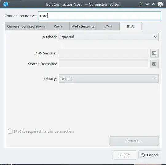

17
Change the wireless setting of IPv6. I tried it with my laptop, which has been continually dropping the connection, and so far, all day long, I have not had a single dropout! It seems to be working. In Ubuntu, in the top right, click on the wireless network icon that shows connectivity. In the dropdown menu, at the bottom, select "edit connections" and then highlight your wireless connection name. Choose edit, then select the IPv6 tab (to the right of the IPv4 tab) and change the setting from "automatic" to "ignore". Save and exit. Reboot your PC. That took care of my problem, and hopefully will yours, too.
D. Thomas
  • 171
Edit the wireless settings, set the IPv6 method to "ignore".
This may be a very simple solution to this problem. My 12.04 wireless connection dropped out every few minutes when connected over Comcast and sometimes also in hotels. This happened consistently on different Comcast wireless setups. On many other wireless setups, it was solid (in my workplace, at Starbucks, for example).
After struggling with many complicated fixes, I finally stumbled across the above solution: No more dropouts.
Edit by cipricus to add images (in KDE Plasma 5.8 interface):

Hi If you are dual booting or using a PC, firstly ensure your Ethernet does not turn off connection to save power, may not be The Solution but it is one step closer. there are 2 that need turning off. Do this Control Panel/device manager/Network adapters right click Properties / power management/ Un-tick "Allow computer to turn Off this device to save power" Since Windows95 it is always ticked by Default and often when one recovers from a crash it is ticked again and needs to be turned off. Hope it helps
