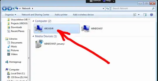

In Windows, go to "Computer", "Network", then choose "VBOXSRV". You will see your shared folder there. If not, then maybe you did not make the folder permanent and rebooted Windows in the meanwhile.
