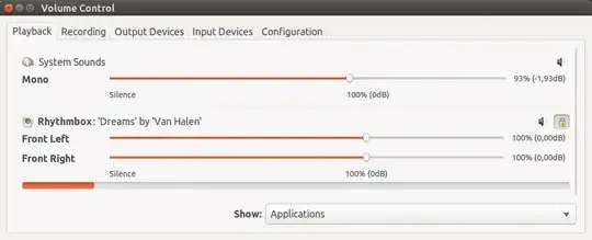

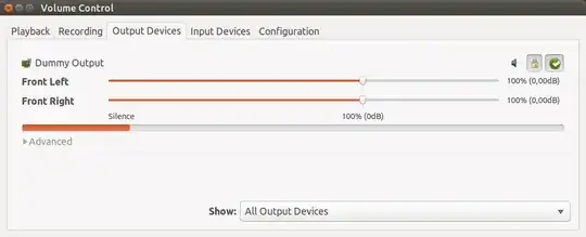

Btw, here are some screenshots.
alsamixer alsamixer output
some pulseaudio tabs while reproducing some soundsPlayback tab enter image description here
Other tabs are simply empty, so it seems that it doesn't correctly recognize my sound card. Any idea?

First , reset pulseaudio configuration by copying this command in a terminal:
rm -r ~/.config/pulse; pulseaudio -k
If not ok, try to disable pulseaudio by running these 2 commands in a terminal:
echo autospawn=no > ~/.pulse/client.conf
sudo killall -9 pulseaudio
then run
pulseaudio
to relaunch audio apps and test. Almost all Linux audio programs can use only Alsa without Pulseaudio (except Skype).
To set alsa volume easier than Alsamixer, install gnome-alsamixer.
