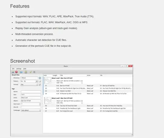

20
There is an app called Flacon which does exactly this.
To install:
sudo add-apt-repository ppa:flacon
sudo apt-get update
sudo apt-get install flacon
