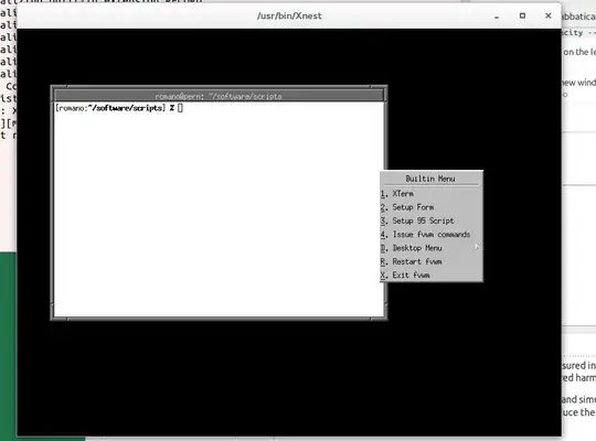

C) Run (notice: startx is normally run with first the client command, then a double dash, and then a server command. As I said, most new systems do not have sensible defaults for startx alone.).
cd ~
startx ~/test -- /usr/bin/Xnest -ac :1 -geometry 800x600
...and you have a 80ies workstation screen:
(You can have the menu by clicking on the "Xnest" desktop).
...and if you feel really adventurous, you can start a native session on another virtual console (read the other answers) by going to one of them with Ctrl-Alt-F1, loggin in, and
startx ~/test
which will normally open on Ctrl-Alt-F8.
Notice: modern desktop environments are not designed to run simultaneously, for the same user, in two different consoles. So do not use gnome-shell or unity or modern things when doing this experiments, or you could mess up your configuration.

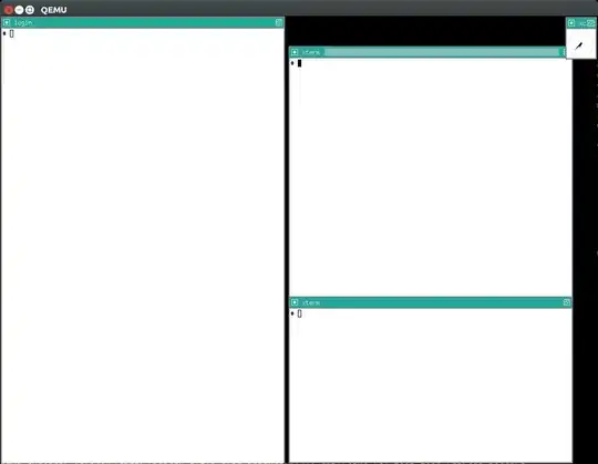

Once you've got the image running on QEMU, you start on a TTY shell.
Then when you do:
root
startx
it starts an X11 GUI:
Now take a look at the source for startx inside that distro, which is just a shell script.
It is a simple wrapper over /usr/bin/xinit, and that it passes /etc/X11/xinit/xinitrc to xinit.
If you open /etc/X11/xinit/xinitrc, it contains the following lines:
twm &
xclock -geometry 50x50-1+1 &
xterm -geometry 80x50+494+51 &
xterm -geometry 80x20+494-0 &
so we see that it starts up:
