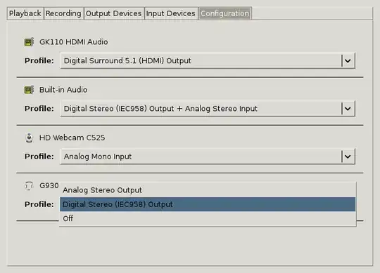

Edit: Checked pavuvontrol under "Configuration":
Screenshot
After restarting Pulseaudio, an additional profile ending with "+ Digital Stereo Input" (or something like that) is available in the list and selected by default.
