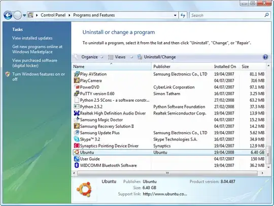

Go to Control Panel, Uninstall a program (Vista/7) or Add/remove programs (XP), and double-click on the Ubuntu entry to automatically uninstall. Reference.
If this does not work, or for more information about Wubi uninstallation (or general Wubi information), follow the instructions to manually remove Wubi

The "easy to uninstall" part implies that you did a Wubi install, which is the easiest to remove. A Wubi install is performed by booting Windows then inserting the Ubuntu Installation CD in the drive. The autorun will then prompt you to start the Ubuntu Wubi installation (install inside Windows). There is also a Wubi installer that can be downloaded and run while online that installs direcly off the internet.
To Uninstall the Wubi installation from Windows 7 follow these steps:
1) Boot Windows 7
2) Open "Programs and Features" in the Control Panel
3) Find the entry for "Ubuntu"
4) Uninstall Ubuntu
Note that in step (3) above, if you can't find the listing for Ubuntu then you might have performed an install "alongside of" Windows, in which case it would have re-arranged your partitions. It seems likely that you have done a Wubi install however.
Yes, Ubuntu is different from Windows. If it was the same it couldn't be better, only "as good as...". Perhaps you'll have another look sometime.
