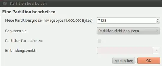

    • The partition editing dialog will open:
      Patition edting dialog
    • Enter the new size for that partiton next to the New size in Megabytes text
      (Neue Paritionsgröße in Megabyte in the screenshot)
    • DO NOT TOUCH THE REMAINING OPTIONS! (Unless you know what you are doing...)
    • Confirm by clicking OK

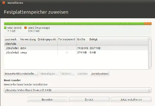

  • The partition manager will now show some free space
  • Select the free space and click Add... (Hinzufügen... in the screenshot)
    • The Create partition dialog will open:
      Partion creating dialog
    • DO NOT CHANGE ANY OPTIONS! (Unless you know what you are doing...)
    • Close the dialog by clicking OK
  • Review the new partition dialog and click Install now
