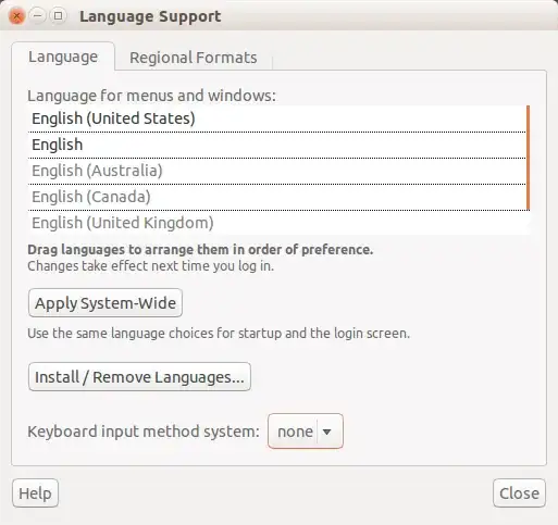

I've tried this out and its working so far but I'll update if it freezes up again. I've seen a suggestion on youtrack that suggests to turn off iBus which seems to interfere particularly because of it's use of the ctrl + space shortcut to change language settings. You can do that by going to:
language support > keyboard input method system > none
**** UPDATE *****
After running it for a while this technique still didn't work as I kept freezing. I guess for now I'll stick to the following workaround to restart ibus which is a bit inconvenient but what can you do.
